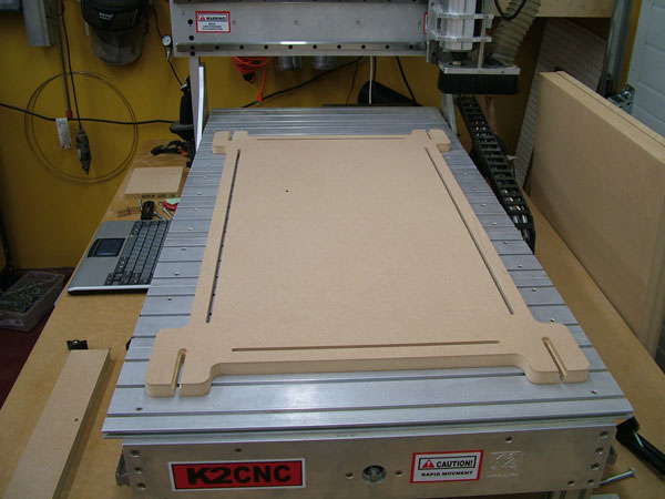

So after two weeks here is what I have made so far:

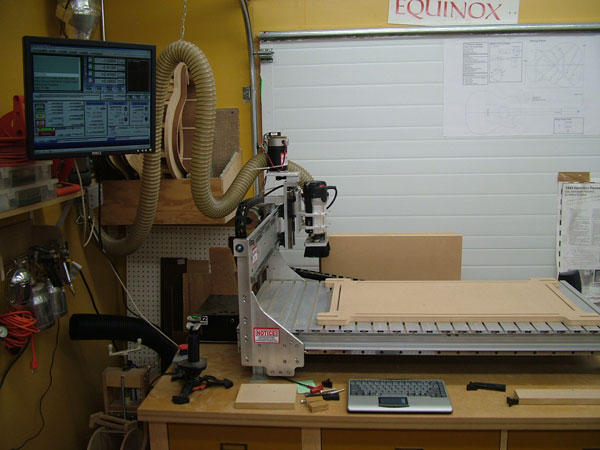

I also changed my setup, found a little wireless keyboard I can walk around the shop with:

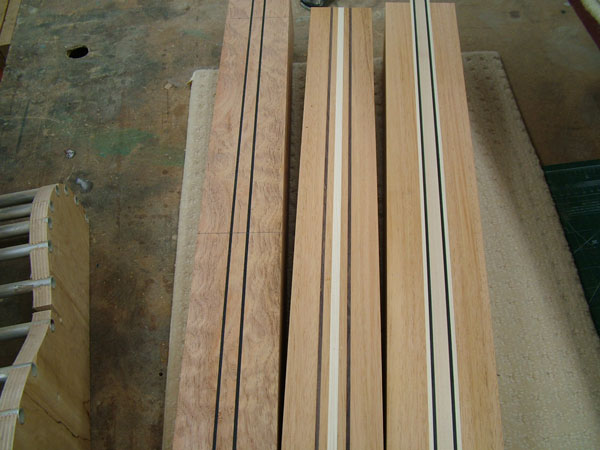

In the meantime I've been getting back to building, here are some new neckblanks ready to be cut up:

Yep.... I'm actually considering mounting a small fan on top of the Z gantry to blow down on the router, I think that will help quite a bit. If you look at the picture the router is clamped in two aluminum pieces and so I can use them like heat sinks, just need to figure out how to mount the fan.
I'm also looking for a 1/8" collet that will fit in my 1/2" quick chuck which by the way works pretty well, it's much better than using two wrenches to change bits. If I can jig a way to keep the height of the bits the same each time then I can create actual tools in MachIII and not have to zero the length each time. I have some ideas I'm toying with....

Paul--I like the looks of your dust collector shroud. I have mine mounted to the "stationary" part of the Z carriage so it doesn't move vertically with the spindle. That's ok for some jobs but other jobs would work better setup like yours.
I have the front of the housing hinged so it will open up for tool changing access.
Looks like it would be fairly easy to drop yours down out of the way for tool changing?
Nelson
PostPosted: Tue Sep 05, 2006 1:31 pm
Posts: 886
Thanks...
Yeah it has enough pressure from the zip tie to hold it onto the shroud, I did modify their shroud some so that the collection tube was stationary (it slipped in before) that way I could put some mild pressure on the hose and it would stay put. But when I change tools I just pop it off and I'm setup, I wanted something simple there, anything complicated would just frustrate me...

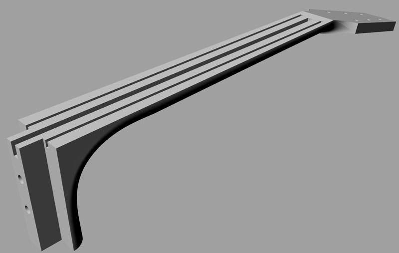

Created this tonight in Rhino, it's my second attempt the first was to prove out some ideas. This one is accurate in it's dimensions, now I have to figure out how the hell I'm going to CNC it
The three slots are for the two CF rods and the Truss, I'm looking for a smaller thinner CF rod currently (1/8" x 1/4"x 18"), that's smaller than LMI or SM but with two that is more than enough to keep things stable...

[QUOTE=Sprockett] I'm looking for a smaller thinner CF rod currently (1/8" x 1/4"x 18"), that's smaller than LMI or SM [/QUOTE]
Paul, try Dragonplate. I just got some that are 1/8"x3/16". Thye may have them even smaller, don't know I didn't look. I got their name from someone else on the forum, just can't remember who it was.
